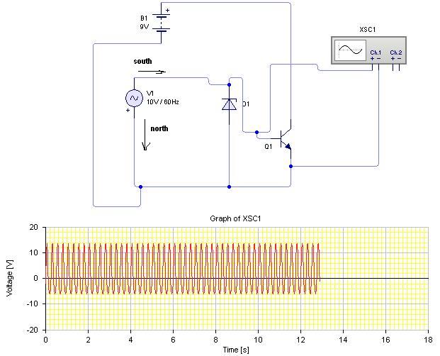

    • The diode here will increase the south pulse positive voltage and current and keep the transistor safe in the north pulse negative current.
      A little moment before virtual south appears... the transistor will trigger on and the coil will charge with current... and this will move the rotor.
      A simulation, the trigger coil generates a sine wave, not a perfectly one but, this will simulate very well what is happening here:

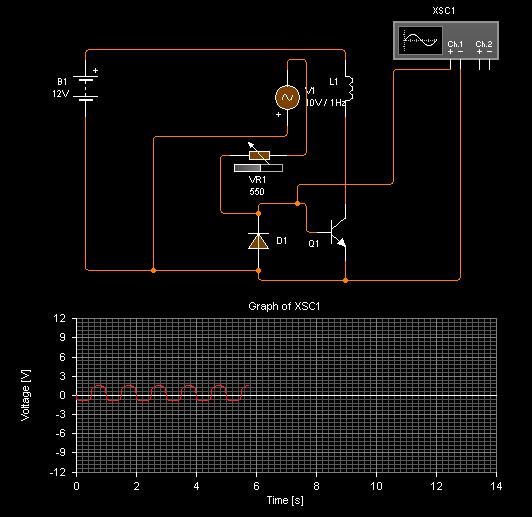

      • try to decrease the base resistor on the transistor , it will produce a voltage increase in the trigger, the resistor in this particular case will decrease the voltage and current and will put some kind of energy here that trigger the transistor this is from my own experience, but if you don't have the minimun current and voltage the transistor will not function properly.
        I don't know why my transistor triggers with values 680 ohm resistance in my setup, , what i saying here is : the colector emitter voltage is 12 volts when the transistor triggers on, the current 50 ma, with a base emitter voltage of 2 or 3 volts and current 1 or 2 ma , this is no conventional trigger!
        simulating my setup, 1hz frequency here is just only to view the wave in the right form
