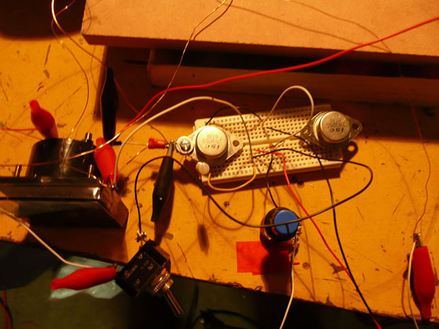

          Second coil is power only with its own transistor. both transistors use common Base and Emitter connections. Diodes off the Collectors join and connect to a analog volt meter from Jaycar so 4 volts would be the total output of both coils. Single coil setup gave me 2.5 volts.
          Voltage across the Emitter and Collector of the second coil reads 19 volts ac yet when I connect a neon across there the neon lights up thought these things only lit above 90v?
          Voltage across the Emitter and Collector of the bifilar coil reads 17 volts ac and when a noen is connected across there it don't light up 'much confusion'

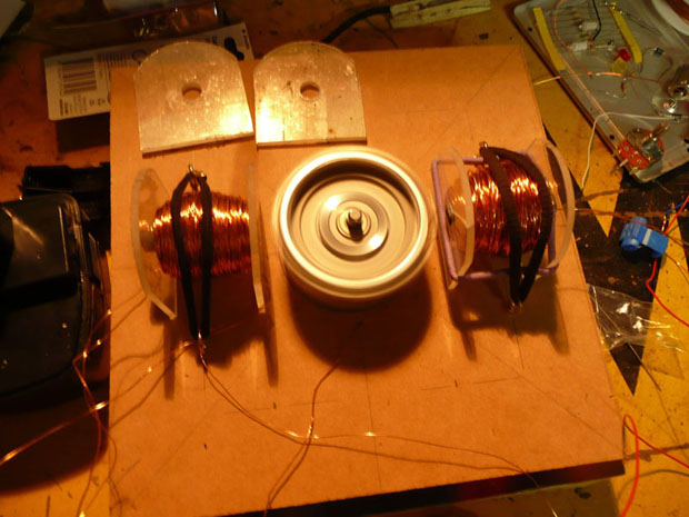

          The coils were quickly made with about 350 turns each, have since beefed up the coil end caps with perspex but the second coil has a few loose windings and is a little pear shaped and hiss's when the SG is running. If I connect the neon across E/C the hissing stops. I suspect the coil is vibrating and will be making a new set of coils soon.
          Jaycar supply only 100g spools of 0.6 wire and 25g spools of 0.4 wire so my coils are made up of joined pieces and this wire is a buggar to solder. Have now just bought a 4kg roll of 0.6 and a 3kg spool of 0.4 so will now be able to make decent sized coils.
          The spaghetti pic shows a spare transistor in the breadboard. The other transistor is out of shot
